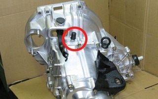

It looks like it probably needs a baffle plate under the breather as in that diagram the breather seems to be directly in line with the large reduction gear which is probably centrifugally flinging oil directly out of the breather.
That's exactly what I thought when I saw the diagram. It's a design problem and the permanent fix would be as you say a baffle plate or move the breather to a position away from the main oil fling. A breather should never be in direct line with oil flow.
Talking about the modified breather ?‍♂️ .

IF the combination of lowering the oil level and extending the height of the breather tube does indeed provide the long term fix, then do we conclude from this, that heavy oil sling from the box is main cause of the problem here.
Caused by overfilling of the cases in production would explain why some cars leak and some cars don't maybe.
So, a belt and braces approach is implement because.
( A ) Less volume of oil to be thrown in a upwards direction, reaching the breather in a mist form.
( B ) Increasing the overhaul height of the breather tube, prevents the oil sling / mist reaching the extra height achieved by extending the tube I wonder ??.
Do I get the impression that every breather pipe will be automatically be replaced though - NO !.

Bluntly both of those "fixes" are bodges.
Dropping the oil level runs the risk of there being too little oil left. I don't believe the "overfilling" story nor the method of checking the oil in the gearbox of draining and refilling. Normal practice is to fit a level plug and fill to that. Draining oil via a drain plug never gets all of the oil out so refilling with a set amount risks overfilling.
Fitting a different "longer" breather may separate out the oil from the air, but a separate return path for the oil is required. Trying to do this via the existing hole size is unlikely to be successful.

A total re-design / relocation of a drain / fill level point is not likely to happen over night, regardless if it is the right fix or not.
I think they are hoping that any oil mist / sling will naturally find its way back down into the sump via gravity, when the car is stationary ?.
They'll be really lucky if that happens. Frankly a catch can might be a better solution.
