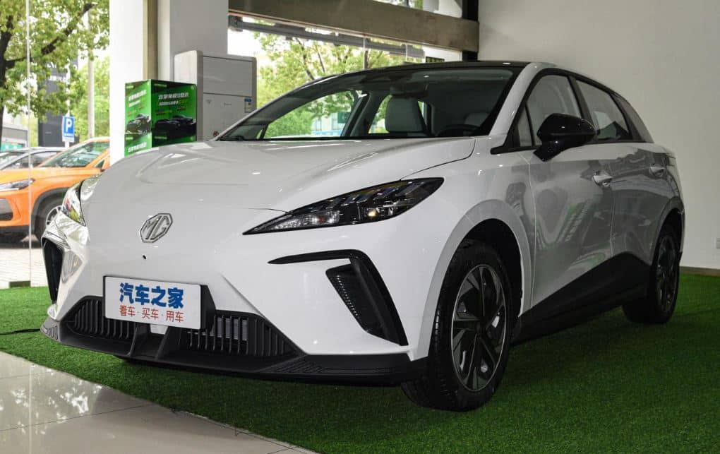

I have seen quite a few comments regarding whether there are leaks on the Chinese cars, i.e Mulan.
Supposedly due to them being available for quite a while over there.
For those commenting as such, according to online reports the Mulan was only released in China on the 13th September, so only a couple of weeks before the UK model hit the dealers.
So not sure where the whole available for quite a while comes from, but that is clearly not the case.
According to this report and I have seen similar reports, the MG4 (Mulan) was released for sale in China back in June and the first batch of 1,000 were sent to Europe in July so based on that there would be a heck of a lot of them in China by now and that is why the question was raised here about possible oil leak complaints there.
The launch you speak of on 13th September was the launch of the MG4 from China to other countries including the UK. It had already been selling in China for around 3 months at that time and over 4 months now.
