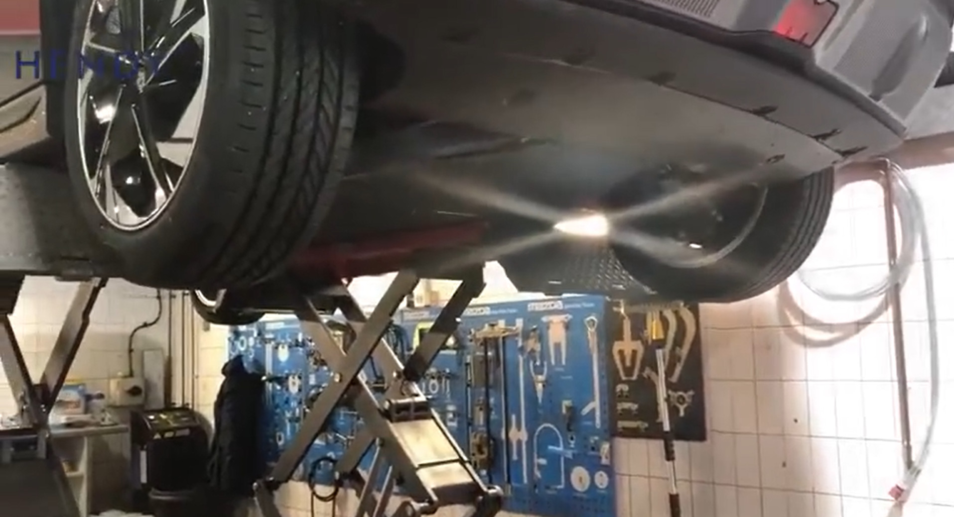

As per agreed compromise, i.e. I was not allowed to be present due to insurances, 2 min underside inspection video received yesterday of my Red Trophy - a little unclear in places due to workshop lighting but overall seems OK no sign of any oil or bulge (for sure car will just have delivery miles). So with the check list sent by a forum member in hand I'm trading in my MG5 LR and collecting my MG4 this Saturday morning ?
Pity, of course it's a nice/happy (call it what you will) time to collect a new car but it is being tinged with some trepidation
View attachment 12608 View attachment 12609
Of course there will be trepidation.
It's not going to show oil leaks if it hasn't been driven yet. No doubt you will be keeping a close eye on it and keep us up to date. :)

Of course, very very low expectation of seeing anything; wouldn't send me a video with a huge oil smear / stain. This a case of course of demonstrating and communicating to the dealer "I'm on their case" with this on the back of my previous email conversations over the past 2-3 weeks about the oil leak issue.
As for keeping a close eye; Hell yeah, will I be ?
