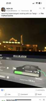

Tesla Supercharger Issue MG5 LR
Looks like MGs can be charged again
Sort of. I went to my local Tesla supercharger this morning (Sidcup), and the first stall I tried gave the dreaded "no car detected plug in to charge" (The car could see the charger, but the charger couldn't see the car.)
Moved to the next stall, and it worked fine, with a rate of 133kw. Mine is the MG4 Trophy.
