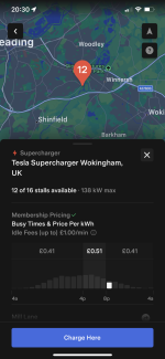

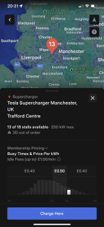

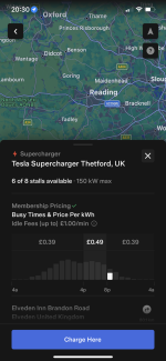

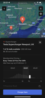

From what I can see from Tesla app as a member prices all over the country are peaking at 51pence. Prices for non-members are around 10-15pence more expensive.
For less than 80KWh the cost of membership is recovered if compared with 65p. It gets even lower, at 46KWh to break even, when compared with 75p from BP pulse. If you drive off-peak times you can make even greater savings.
Prices on/around M4 / M40, Hertforshire A1 /Cambridgeshire for DC chargers start at 66p up to 75/79p (BP pulse/MFG taking the crown). The odd/single DC charger somewhere inside a town might be a bit cheaper. But when I'm travelling on the motorways driving another 5-10 miles to find that charger, hopefully available and working it's kinda of a gamble.
So in my opinion Tesla offers a compelling case for drivers on long journeys if you happen to have one SC on your way.
