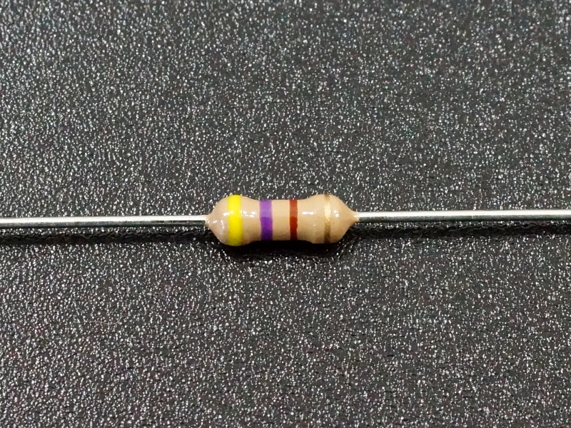

With one should I use?

Use 0.25W 470ohm (470R)
It will likely have these stripes:
yellow, purple, black a space then brown or gold, or
yellow, purple, black, black, space then brown.
It will be the smaller of the two. If the larger 1 W version fits, it will work just as well electrically, and might be a tiny bit more robust than the smaller one. But really, use whichever is the most convenient.
The 470 kΩ resistors are nearly open circuit (1000x more resistance than required), and won't work in this application. But they will likely have cost less than 1% each of the shipping.
