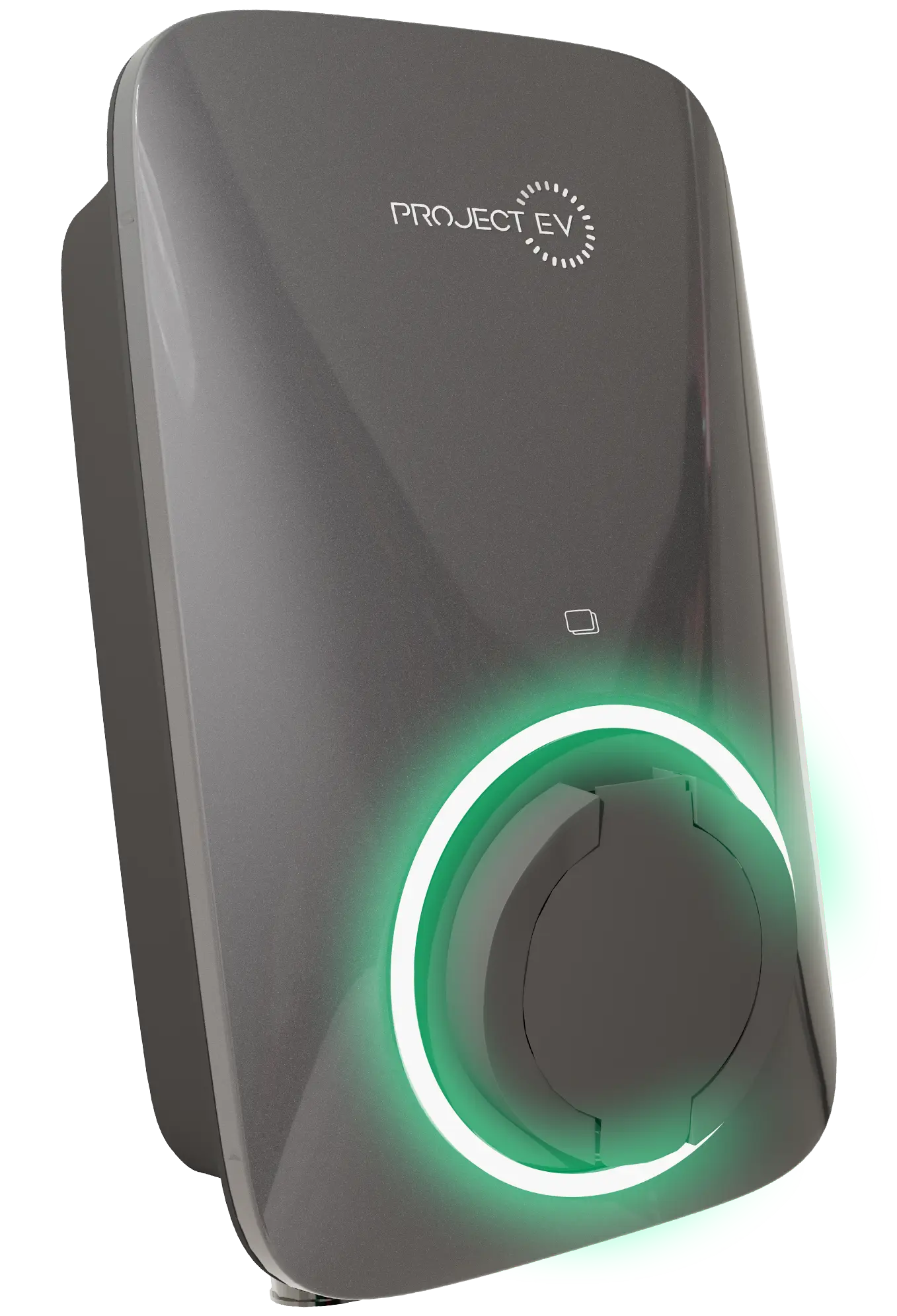

i have gone for this its smart and its reasonable price plus you dont need a earthing rod
We have basically stopped fitting other chargers in favour of this model, it has all we need for a cost effective install, App isn't the best, but it's given us no problems and the customers all seem happy with it..

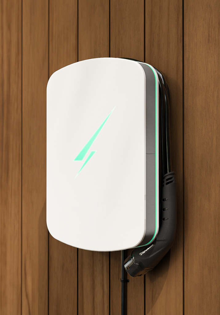

Ooo, that’s lovely. I did an internet search for the Hypervolt in Australia and this is what came up ...not quite what I was looking for...
Was practicing my new-found Googling skills and look what I stumbled across...
I was due to get a Rolec charger and I have an installation date of 1st July. However after watching the video on You Tube I think I would prefer the Hypervolt instead.
This company will install it for £599.
I am tempted to cancel the Rolec one and go for this instead.
I am more than happy with my Hypervolt. The company who were going to install my Rolec charged £580.
Now just need the app to be updated as it calculates usage at a flat rate of 14.15p/kWh and you cannot change this.
