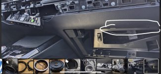

it sits just above the glove box. it is best to loosen the screws and remove the frame from the glove compartment. here is a photo of the connector. Would be nice if you could write down and document the assignment. I haven't gotten that far yet.

I have a friend in an mg dealer! Also have a wiring schematic for the infotainment
Unfortunately the wiring colours don’t give much clue as to which is which.
The EQ I will have a play with. I’m on an SE SR car so there’s no 3D sound to turn off, just loudness and the EQ settings.
Attached is a picture of the left passenger side speaker connector. The colours match what the tweeter has but which is positive and negative I’m none the wiser. The colours then for the driver side are different again.
