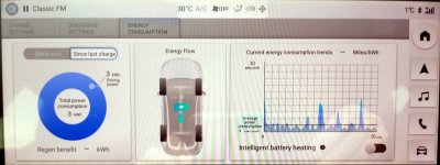

But, again I am confused. Do you not have the standard centre display that gives you access to the battery status (see my previous photo) plus power consumption figures and discharge data if you have V2L?

Further to the above, here are the images from the info display on my Trophy, including one from the power consumption tab after tapping the battery panel from the home page.
You should have similar. If not, could ok please you post some photos because a picture is worth a thousand words.

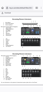

In the UK the display could be one of two types - with and without navigation. The MG UK website quick guide document shows the image below. The displays may have changed for later versions.
There are common elements, eg the battery tile, giving access to the images in my previous post. Your profile says that you have an SE so do not have navigation.
