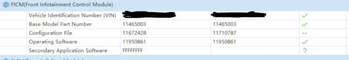

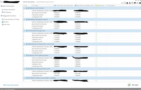

I read out my MG4 via SIPS using the VDI3 device. All control units show a green check mark. However, under “Matching” some entries are marked with “-–”. What does this mean?
I was also unable to update any of my control modules via One Press, as the “Next” button was greyed out.
In addition, the FCIM shows a “?”. What could this be? Maybe the USB updates of the RXX versions?
You're using the newer software, revert to an older version
Those commenting about network setup on installation, it should be done with the interface connected
Although it's a USB connection it's ethernet over USB, so the network it's trying to setup is for the adapter not Internet or anything else
