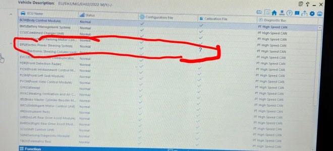

Can someone explain why the "Calibration File" in EPS shows always a "?" ?
I've already reflashed the "EPS" using "replace" and recalibrated it.
All modules are up to date.
German Trophy from the end of 2022
The updates was smooth without problems with vnci?
Yes, everything went smoothly.
The "?" has always been there in SIPS, as long as I've had the car and SIPS installed, even after the workshop / Car Dealer performed updates.
In the view where you can break down the modules individually, all modules are up to date.
