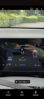

Managed to plug DC charger today and it worked, but did throw up error message HV battery shut off. No idea what this means
Morning, charged vehicle to 100% over night on house charger. Range is saying 238 miles, I have a trophy and this used to be around 300 during warm weather, not sure if this battery error message is causing this.
This is the error message when plugged into DC charger

I get that error message when a charger (whether AC or DC) is plugged into the charging port but it’s not active. The car shuts off the HV battery and you’ll see the red 12v battery symbol meaning the 12v battery is not being charged because the HV battery is now, for safety purposes, shut off.
