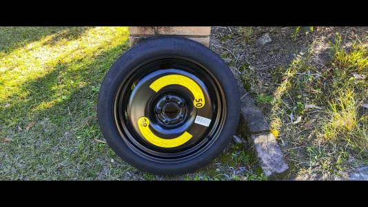

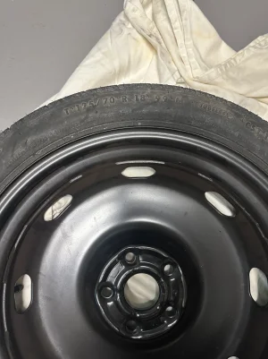

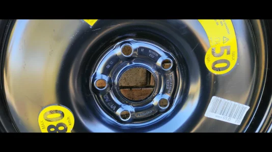

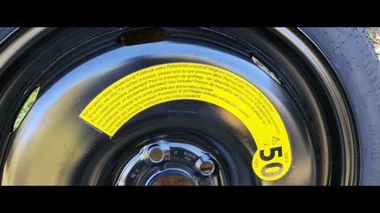

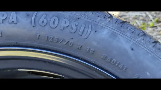

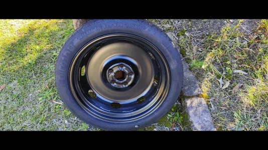

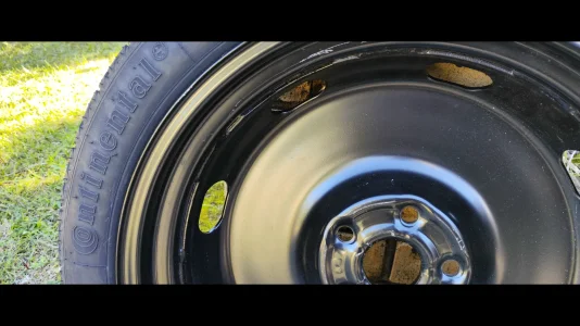

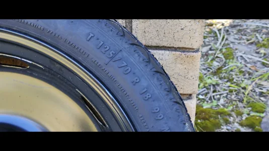

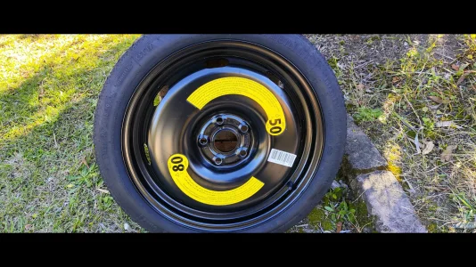

Ok so I got a spare wheel / tyre a Volkswagen Golf Space Saver Spare Wheel attached photos, I thought this was the correct one for my MG77, I went to Mycar today to get them to make sure it fits and they told me that the wheel doesn't fit and it's scraping the brake caliper. Could this be the issue with the 77 and it fits the 51 and 64?

I’ve got what I am pretty sure is the same spare, and it fits my Essence 64. I tested it myself, bolted it on and spun the wheel.
Let me check the part numbers on my one tomorrow to make sure it’s identical
ok thanks it will be interesting to know.
ok maybe it will fit the 51 then.
My vague recollection is that it's the front (possibly the back!) calipers of the 77 that are larger than the 51 and 64 in either spec and that don't fit that VW spare.
I got the braumach spare for this reason.
We have both a 77 and 51 but only take the 77 on long trips (and pop the spare in the boot when making them).
I also got a pack of the "plugs" that you can use to "fix" a typical flat...
Boy scout ;)
Boy scout ;)
ok that's interesting maybe I will take it to another tyre shop and see if it fits for the back wheels on my 77. I also have the plugs.
This is what I found on the interweb about brake disc sizes.
MG4 Brake Disc Sizes:
  • 2WD 51kWh & 64kWh:
    • Front: 280mm Ventilated
    • Rear: 260mm Ventilated
  • 4WD 64kWh & 2WD 77kWh:
    • Front: 320mm Ventilated
    • Rear: 280mm Ventilated
  • XPOWER:
    • Front: 345mm Ventilated
    • Rear: 340mm Ventilated
I checked the spare that I have (see photos). It has the same dimensions as yours:
3.5” width, 18” diameter and offset 25.5mm. Interesting that they use both imperial and metric measurements in the one description. The part numbers are different but pretty sure it’s the same wheel to all intents and purposes. The tyre is also the same specs.
So from the disc sizes above it looks possible that it will fit the rear of your 77, but not the front. (I tested my spare on both front and back, must have been feeling energetic that day!).
My impression was that there was plenty of clearance when I test fitted it, but it’s hard to judge the distance with wheel bolted on to the caliper behind it.
