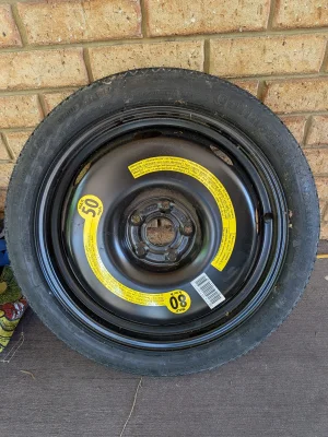

I have the same space saver from a VW golf and a dry fit only works on the rear of the 77. The Front caliper is way too big for it. Looks like a hunt for a relacement.
It will still work for now, I will just need to add a car stand until
i can replace it.
