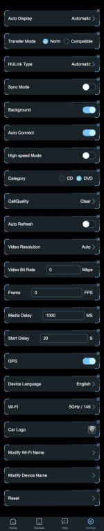

Still having issues with the 2Air CarlinKit 5.0
Blank screens, or no connection at all. Sometimes it works but zero pattern to it.
Today after stopping twice to get it going, which involves are lot of farting about, it froze up after about 15 minutes. Requires an infotainment system shut down and sometimes that helps it start up. Often with a blank screen though.
I pulled mine out of the “pfft, cheap junk” drawer and thought I’d give it a second chance (after previously trying it for a few days with the same results as you and it getting stuck in reboot loop after updating) …
But after viewing the thread over here I thought I’d try:
1. Factory reset it while connected to a usb power adaptor instead of connected to the car, and
2. Try the settings below (NB: the WiFi channel’s not relevant - I just use CH149 to avoid overlapping with a nearby router)
And lo and behold it’s been fine now for days and no freezing/blank screen/rebooting ?‍♂️
I've just duplicated those settings, so we'll see how it goes. Thanks for the suggestions.
Just noticed comment on Wi-Fi channel. I did also set that to 149 but checking my home router I see it's also using channel 149 on the 5GHz band, so I may need to change the CarLink setting back. Can't recall what it was, 30-something I think.
Up to now it would go through multiple cycles, usually eventually coming on line. It might take 5 minutes or so of cycling though the start up process, but sometimes it would fire up straight away.
With the new settings, have only had three drives so far but it's 3 for 3 the Carlinkit CarPlay starting up without issue.

This morning it would not connect. Phone was connected to the unit as I could see the webpage but no Carplay. In the end I had to unplug the Carlinkit and plug it back in. Then it worked. Later in the day another drive and it started up OK.
