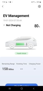

This is today's range this morning at minus 7c. All my recent jouneys have been short ( no chance for battery to heat up much ) with 22c heating on and heated seats . That's 158 miles at 80 percent which equates to 197.5 at 100 percent. This is really for any newbies worried if their car is faulty. I can categorically say in the summer the range will be at 330 miles at 100 percent.

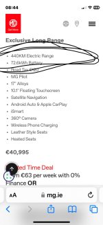

Hi all, I have a 2023 mg zs. Based in Ireland. As per the website details the exclusive long range should be 440km on a full charge. I’m only getting 350km when charged to 100% . This is in eco mode( less if in normal or sport).
Anyone else having these issues?

Hi, if you put a few words in the search bar you will find a few threads on this.
Basically it's cold out and the HV battery doesn't like that. Plus you have probably been using the heater and light etc. Try resetting the trip counters.
