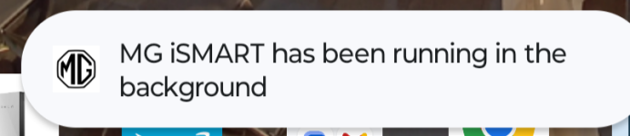

Yep a warning just momentarily popped and disappeared 2 seconds later on my mobile ! Screenshot_20230830-162820~2.png
Went outside to the car and noises again like relays were coming from under the bonnet. Ismart version 1.1.13 running on Android. Wonder if that's causing a flat battery?
I always get this message when I shutdown the app. I have had no problems with my 12v battery. Mind you I always power off my phone at night.
