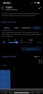

Zappi charging and cell balancing on LR
Hi, I’ve seen some threads saying that when you charge up to 100% a cell balancing routine will start. This typically consumes around 500w for maybe an hour or so.
However what I’m seeing on my Zappi is that when the charge reaches 100%, no further current is supplied for the cell balancing. It just drops from 7kw to 0. And the Zappi displays “charge complete”
So I guess my questions are;
Does cell balancing always happen at the end of a 100% charge?
Any other Zappi owners seen cell balancing happening, ie 500w?
Have any owners of different chargers seen cell balancing and the reduced current?
This image shows the zappi current dropping to zero at the 100% SOC

Done maybe 10 charges to 100%, over 7000 miles on the car now. Would have expected with that milage some balancing would be needed. But always the same result

Is it possible something might have change within Zappi maybe been update over the air perhaps.picture below this morning car full Zappi had turned off.

I typically set the charge to 80% on the infotainment screen. But have noticed it has a habit of changing itself to 100%. Not sure if this is a bug or something to do with wanting to cell balance.
Also last night, did a timed ECO+ charge with plenty of time to let it get to 100%. As you can see from the image, at 3.30am the charging wattage started to decrease, and by 3.55am we were down to just a trickle of around 80 watts. This continued for another 45 mins or so.
This is the first time I've since the trickle charge on any 100% charges that I've done. So wondering if this actually was cell balancing?

Sounds like it.
That’s it Al you said you normal set to charge to 80% in the screen well the car won’t balance unless it’s at 100% but what you have on you graph above which is a balance charge and this needs to be done around once a month as I have said before you can’t control the balance if it needs to it will do it but only at 100% state of charge the amount of time it does it for will also varying so don’t forget that also
