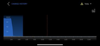

My Zappi charges to 100% then stops - there appears to be no battery cell balancing. However, when I use my Ohme (to take advantage of Intelligent Octopus rates) - as we did this morning - then there is a period of Battery Cell Balancing that appears to take place at the end of the charge - as shown by the screen grab of this morning charge attached. We only ever charge at home - so I vary between using the Zappi for free sunshine power - and a regular 100% charge using the Ohme.
