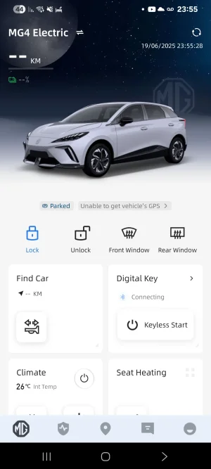

Do you need with up to date BCM, GW and T-box software to refresh the app to get data? It does an automatic refresh when i start the app, but doesn't show data.
Nope, because the app is using Saic Motor servers to work. But if the TBOX isn't fully operational, The app won't work.
The car need data to work with the App.
The app works, the problem is that the automatic refresh don't show data. I need to refresh manually every time. After i refresh manually it's work
The app works, the problem is that the automatic refresh don't show data. I need to refresh manually every time. After i refresh manually it's workView attachment 37622
Yeah, it’s the same for everyone. Gotta refresh manually like 2-4 times before the data finally shows up.

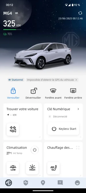

Just launch the app:
After refresh:
Sometimes, the refresh is done automatically but most time, I need to do it myself
