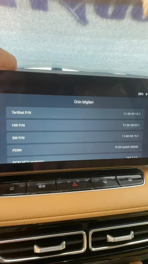

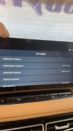

Hi everyone, I've been trying to get iSmart for a while. I own a new HS Phev. My vehicle is giving me a network error, and the iSmart QR code isn't being generated. Furthermore, the weather forecast isn't active. When I check the engineering menu, I don't see the MCU version. When I asked the iSmart Europe team about this, they said my vehicle was scanned in the database and the telematics box wasn't activated. When I reported this to the local service center, they said they wouldn't do it. I don't have a VDI device in my country either. I also can't make payments to the MG RMI website, and PayPal isn't available in my country. Can someone help me? You're a knowledgeable person on Haloweenhamster, what can I do about this? @haloweenhamster

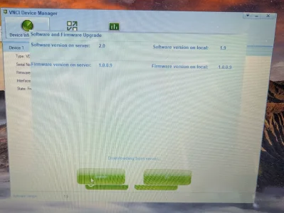

There's an update for the VNCI Device Manager from 1.9 to 2.0, but I don't know how to download it?! When I click "Upgrade," something downloads, but then I get the message "Upgrade failed."
