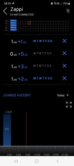

Four attempts to charge it with the Zappi tonight, going from around 40% to just over 60%. Here’s a screenshot of the charging history for reference. The fourth attempt was the shortest.

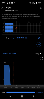

Quick update on my situation. It happened again last night, first time in nearly two weeks. Luckily I woke up at 2am and decided to check it, noticed that it had only put 2 kWh in and went to the charger to unplug and plug back in. Put it on fast mode and it was at 100% when I woke up at 6am.
I noticed something different this time that I don't remember seeing before. My WiFi went down at roughly the same time my car stopped charging. I mean it could be a coincidence but right now I'm trying to look for similarities in our situations. Is everyones chargers networked via WiFi or hard wired over Ethernet? Also, what kind of WiFi system do people have? I've got three Google WiFi pucks that create a Mesh network over my house.
