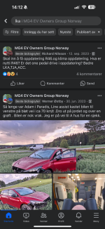

We already have one LKA documented accident in the Norwegian Facebook group. The car was wrecked.
I didn't realise that the accident had been proved to be caused by LKA, could you please supply the documented proof? It will help others if they have similar accidents caused by MG4 LKA system.
I believe it was posted in another thread - there isn't proof in terms of a dashcam or with inside video showing the dash, just pictures of the aftermath and the account of the owner.
I expect it wouldn't stand up in court, would be claimed as driver error.
What is needed is thorough independent testing on really roads to highlight the issue.
You have to use Google translate from Norwegian to English, but he basically says that LKA pulled his steering wheel on a narrow road and wrecked his car. Guy was also sent to the hospital.
I doubt any of this would standup with your Insurer or with MG as it is always
made clear that the Driver is ultimatly responsible.
That first picture looks odd. Unless the LKA spun the car it must have guided it through the gap between the signpost and the tree. But there are no tracks. The car seems to have gone a long way into the field assuming the driver braked hard and countered the LKA force when he realised the LKA was in error.
There was more pictures in that FB thread with the clear visible marks of where the car went off. It was not in a corner, pretty straight low-quality narrow backroad.
