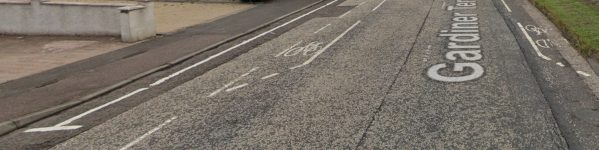

A couple or road makings in my local area that make the LKA throw a hissy fit, and probably would confuse any logic driven lane keeping system.
No bike overtaking when approaching an island, for the car to keep in lane logic dictates it must drive over the island or breathe in like the Harry Potter double decker.
A white line for a driveway coupled with a dashed line for parking at the side of the road and add an extra line for a cycle lane.

Is this mixed type of lining and road characteristics typical for the following : "Sometimes poor road surfaces, certain road structures or objects may be mistaken for lane lines." ??
Because if so, MG tells us you must immediately disable the lane assist system.
Is this mixed type of lining similar to what MG states in the manual ? : "The lane assist system does not always recognise the lane lines. Sometimes poor road surfaces, certain road structures or objects may be mistaken for lane lines."
