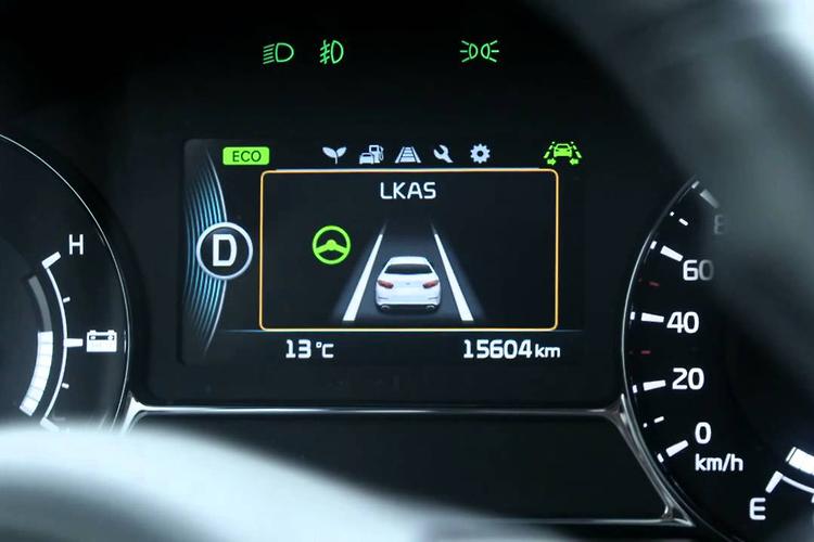

I think the 4 has a similar function because the lines brighten on the driver's screen when they are detected. The nearside line is more difficult to detect a change and I don't know if the car believes the road edge is a lane marker.

Herself's Kia Eniro does exactly that and she never turns it off, and it never behaves erratically, just gives a slight nudge/resistance if you get too close to the line (and only where marking are clear)
