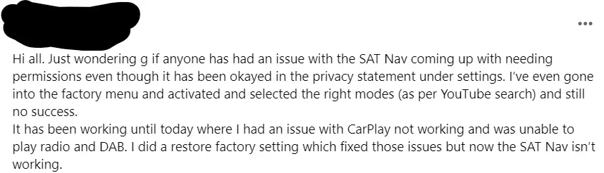

Yes, however... see this:
When I picked up an MG4 Essence 64 media loan review car recently I did a factory reset to clear out the previous drivers settings. When I tried to open Sat Nav the car displayed "Permission Required". This is how I fixed that error
