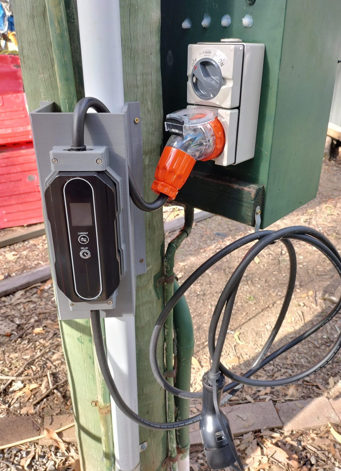

We have the same version and yes the same 1.3 to 1.4kW from the granny charger. We have 3 phase power to our house here and so after looking at the cost of installing a charger I went a slightly different route.
I got a 3phase 32amp outlet installed on the meter box... which happens to be where we park the car. Then got a Portable 3 phase charger from INCHARGEx which is a 3phase 32amp charger with a 3 phase plug on the end (portable) so this means the all the cost of paying a electrician and adding the cost of a socket and isolation switch I know have a useful 3phase plug as well as a charger. The charger only cost $380 plus the install... which for us, was part of a Solar system upgrade which was funded by the $6000 rebate we got from the car. So we can charge at around 6 to 7kW at a fairly cheap price.
Just in case you don't know... the 51 kWh car only charges on one of the pins in the car socket (open the charging door and you can see the middle pin is metal and the other 2 are dummy) so you can only charge at around the 6 to 7kW as you are only charging on one pin and not at 21kW if you could use all 3 pins on the car.

We have the same version and yes the same 1.3 to 1.4kw from the granny charger. We have 3phase power to our house here and so after looking at the cost of installing a charger I went a slightly different route.
I got a 3phase 32amp outlet installed on the meter box... which happens to be where we park the car. Then got a Portable 3 phase charger from INCHARGEx which is a 3phase 32amp charger with a 32phase plug on the end (portable) so this means the all the cost of paying a electrician and adding the cost of a socket and isolation switch I know have a useful 3phase plug as well as a charger. The charger only cost $380 plus the install... which for us, was part of a Solar system upgrade which was funded by the $6000 rebate we got from the car. So we can charge at around 6 to 7kw at a fairly cheap price.
Just incase you don't know... the 51Kw car only charges on one of the pins in the car socket (open the charging door and you can see the middle pin is metal and the other 2 are dummy) so you can only charge at around the 6 to 7kw as you are only charging on one pin and not at 21kw if you could use all 3 pins on the car.
Thanks for your response @Calm as .
That's good to know that there's nothing wrong with my charger or car.
Your information was especially useful as I have a very similar set-up.
I also have 3 phase power at home and also charge my car right next to the meter board.
I didn't even realise that it was possible to get a 32 amp power socket. This gives me some useful food for thought. I'll look into the cost of getting a similar set up installed
@markinoz no probs... spent plenty of time getting confused but sort of gotten my head around it. the Inchargex guys are in AUS so they are legit and it's done to standards. For me it was a no brainer not to get a wired one in... As good as the MG4 is it may not be my last electric car so I wanted the flexibility to use the same point to charge a different car with different charger... be it not at the same time but at least without as mach as unplugging one charger for another.
