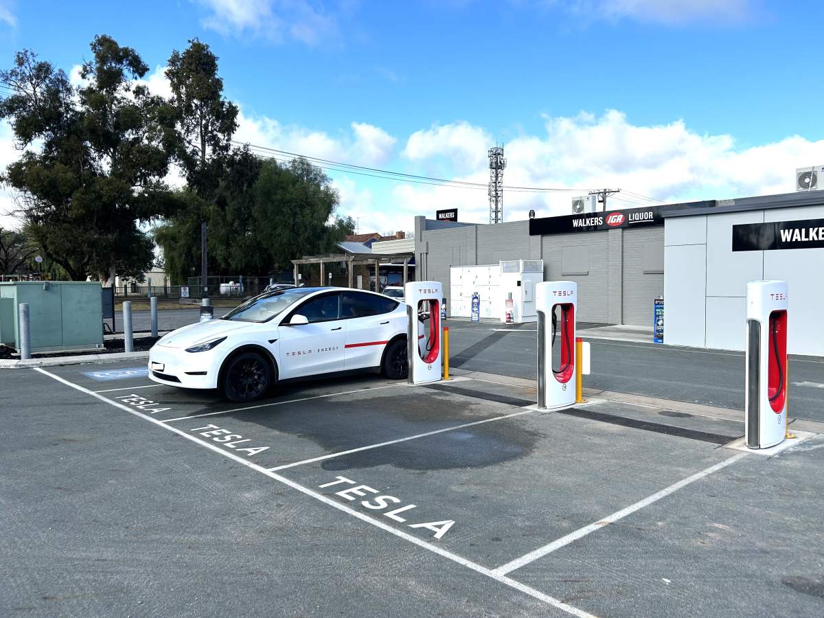

Any Supercharger site which receives govt support funding will be open to all EVs. Any other sites Tesla installs it is entirely up to them whether to open them up for non-Tesla use.
A little over half of their Supercharger sites are open to non-Teslas.
