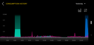

I have an SE SR and thought I'd caught this problem of the failed CCU but checked with a Granny charger and somebody else's wall box and fortunately nothing to do with the car. So it's worth checking with other AC chargers before focusing on the car.
Mine was the Zappi, not faulty but it was losing coms with the (EDIT internet rest of my Myenergy system) and apparently as part of the latest regs, has to stop charging if that happens (EDIT I'm probably miss quoting this a little see #361 for clarification). Mine was stopping and starting, look at the left of the screen shot, looks like solar charging but it's in the early hours of a January morning.

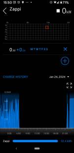

Check the Zappi event log for a day that you had poor charging, if it looks like the attached then there is every possibility it's (EDIT internet coms) related. A good log will have a couple of lines, literally starting charging, finished chrg. You can see the log ONLY ON THE Zappi, not app or PC with MENU, DOWN, PLUS select the day in question. Also if you notice a red light in the myenergi logo (car attached or not) its having a problem, then check the log.
Ours will go for days without a problem then start messing about, often on a damp or rainy day. Our Zappi is a long way away and using the ME proprietary wireless, not WiFi. I now have all the bits to hardwire it with Ethernet.

Check the Zappi event log for a day that you had poor charging, if it looks like the attached then there is every possibility it's internet related. A good log will have a couple of lines, literally starting charging, finished chrg. You can see the log ONLY ON THE Zappi, not app or PC with MENU, DOWN, PLUS select the day in question. Also if you notice a red light in the myenergi logo (car attached or not) its having a problem, then check the log.

Did yours ever say charge complete? Even though the MG4 battery wasn't fully (60-80%).
@Alex Brumpton Oh there's a question, can't remember for sure if the app had charge paused ⏸️ , charge completed with a tick or some other indication that it had come to an end without reaching 100% but yes there was some tell tale difference to normal.
I knew immediately it had done something unusual as the amount of charge was far less for the duration of hours if that makes sense. In my world on regular Go for instance the car would almost always rcv 24.3 kwh in a 4 hour charge as shown in the ME app. I think one 4hr session I rcvd 11-13 kwh when I knew the car was less than 50% at the start and should have been virtually 100% - so it was short charging.
Now I have known the MG4 get fed up with erratic charging and declare itself done with a charge session when not at 100%. This has been when I've tried solar Eco+ charging. On a fluffy cloud day standing by the car with the sun going in and out, you could hear the contactors in the MG clicking away and after a while it will stop taking a charge even if a huge blue bit comes along. As much as to say - if you keep messing about, then I'm done charging.
The key signature for me is the charge graph in #344 above.
